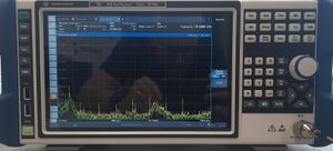

Rohde & Schwarz EPL1000 Scanning Receiver
The Rohde & Schwarz EPL1000 Scanning Receiver device driver is a Spectrum Analyser which is supported by RadiMation®.
