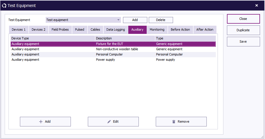

==== Auxiliary ====
Auxiliary devices include all supporting equipment that does not fall under other categories.
This may include passive objects (fixtures, tables, loads) or configurable auxiliary devices.

Auxiliary[edit]
Auxiliary devices include all supporting equipment that does not fall under other categories. This may include passive objects (fixtures, tables, loads) or configurable auxiliary devices.
